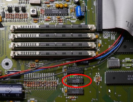

I have just come across this thread after much searching. I am keen to have OSD for my Atari STE for all resolutions, well at least for colour for games. What points do I connect my custom firmware Gotek to for low resolution mainly and is there an official guide so I also know what pins on the Gotek to connect as well?
Re: Gotek OSD not working on Atari Hi-Res (wrong refresh rate)
DeckerZ wrote: Thu Mar 11, 2021 2:59 am I have just come across this thread after much searching. I am keen to have OSD for my Atari STE for all resolutions, well at least for colour for games. What points do I connect my custom firmware Gotek to for low resolution mainly and is there an official guide so I also know what pins on the Gotek to connect as well?
The OSD documentation is available there :
https://hxc2001.com/docs/gotek-floppy-e ... splay.html
The STE has the CSYNC signal so you only need 2 wires (the video signal and the composite sync signal).
You can use the pre-built OSD firmware available in the the HxC firmware archive.
If you have an STE with the RF modulator you can find the CSYNC signal on U211 at the pin 6 :
