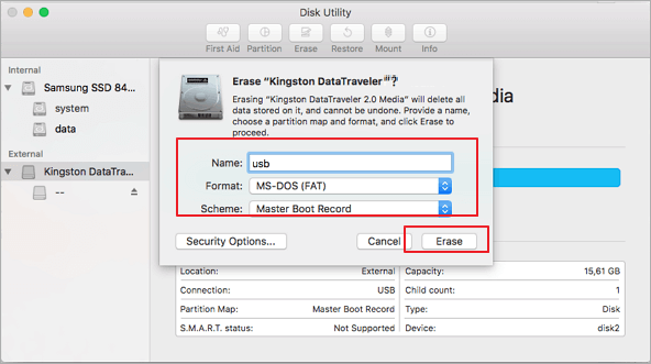

Re: HxC firmware update to beta problems
The right parameters on macOS to format the sdcard : FAT + "Master Boot Record" option.
