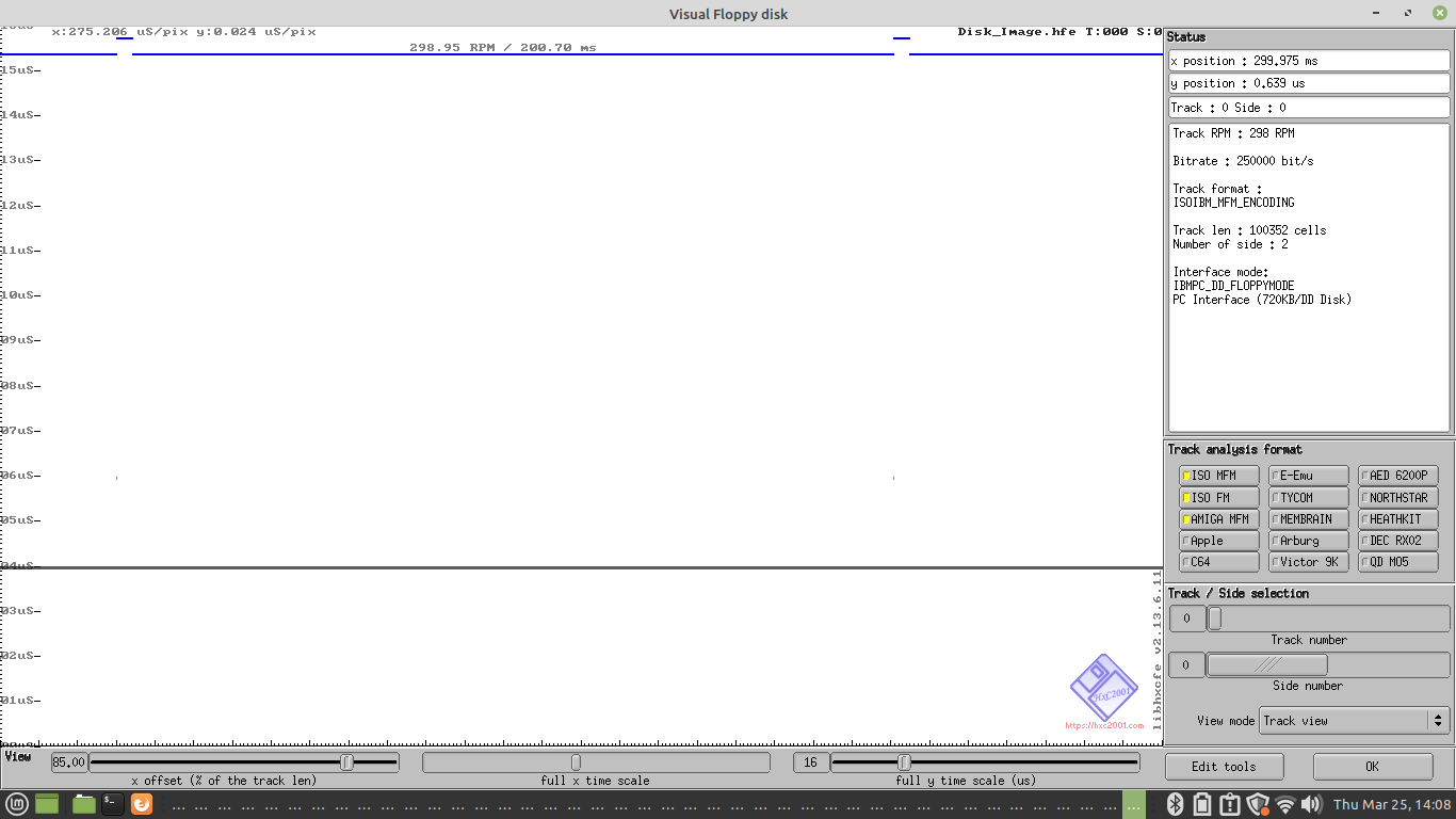

Look like both sides of the first cylinder was blanked :
I see two possibilities:
- The index signal is not working properly (controller and/or floppy ribbon and/or gotek hardware malfunction)
- The write data signal is not working properly (controller and/or floppy ribbon and/or gotek hardware malfunction)
Since you can write sectors and read them back (have you tested this ?) , i recommend you to check the index signal.
BTW are you using the "normal" 3.5.2.5a or a custom version ?
