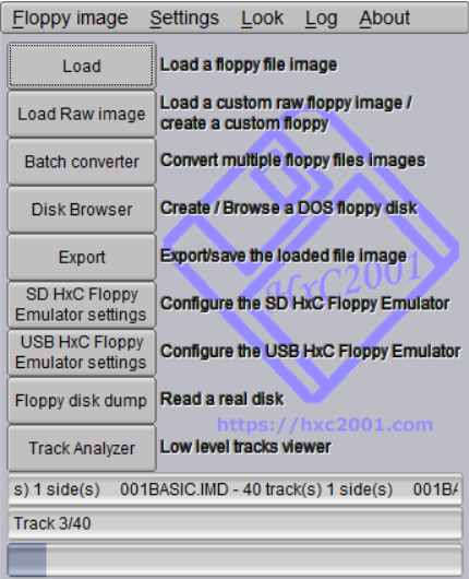

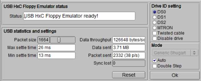

The great news for me is that I now have USB HxC floppy emulation working for Cromemco computers both 5.25 and 8 inch
First I learnt that the USB HxC is only read only
Then I found that all the debugging (trying to get read/write working) had resulted in a critical wire coming loose.
There is the hardware mod that ties the READY line of the 2 different parts 5.25" and 8" of the controller together so that you then need only
use the 34 pin J2 connector of the Cromemco 64 FDC Disk Controller for all emulated drives
Example Working
03 hxc.jpg (27.56 KiB) Viewed 6888 times
04 hxc.jpg (21.13 KiB) Viewed 6888 times
cdoscopy -l sfda

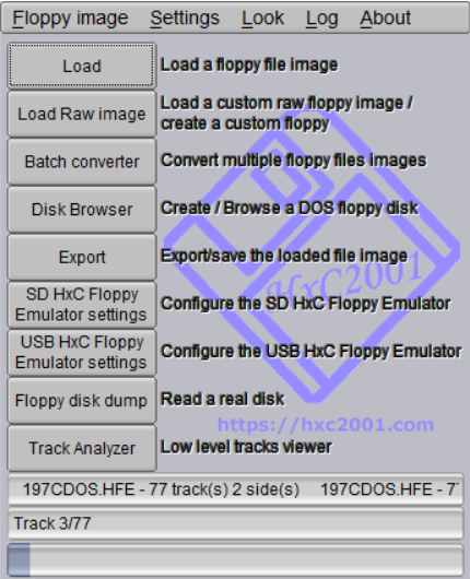

And for 8" Diskette
05 hxc.jpg (27.53 KiB) Viewed 6888 times
 cdoscopy -l fda
