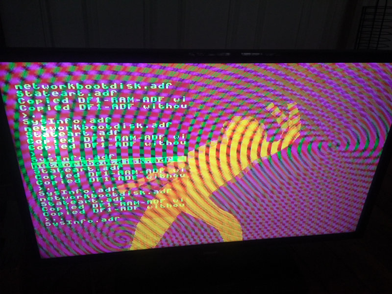

I have finally added the AT32F435 OSD support :
Attached the beta firmware (for AT4.35 (AT32F435) Goteks)
Happy New Year !
Happy New Year !
