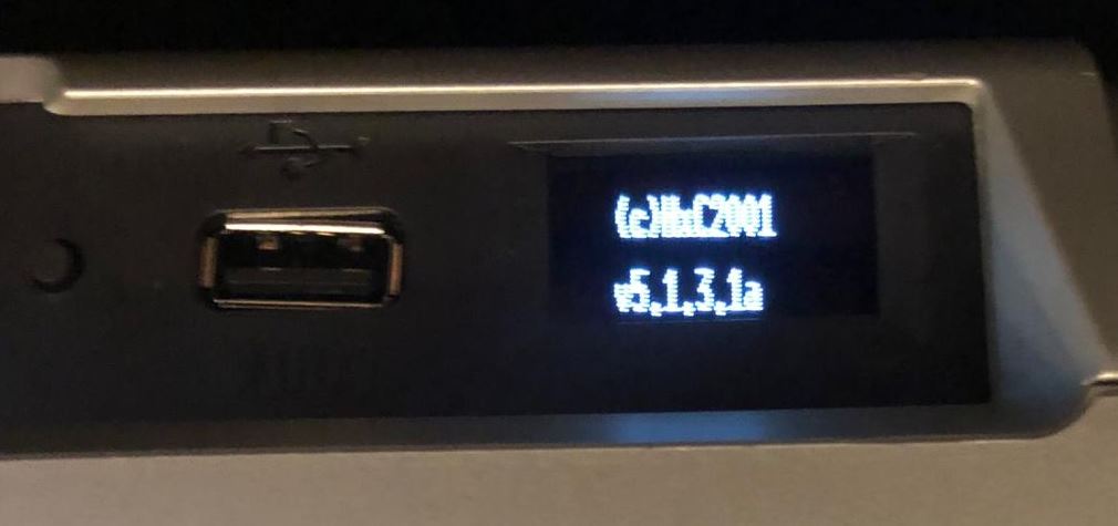

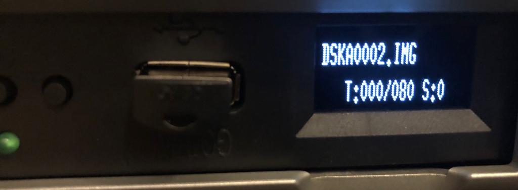

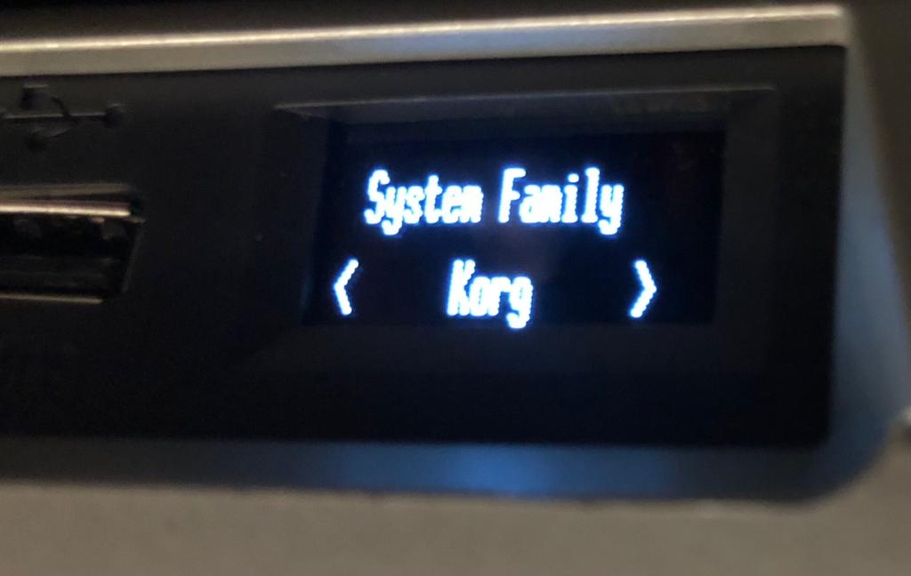

Hi, I've purchased de firmware and now when I start the unit it appears the message: (c)HxC2001 v5,1,3,1,a so I assume that the flashing and update is well done.

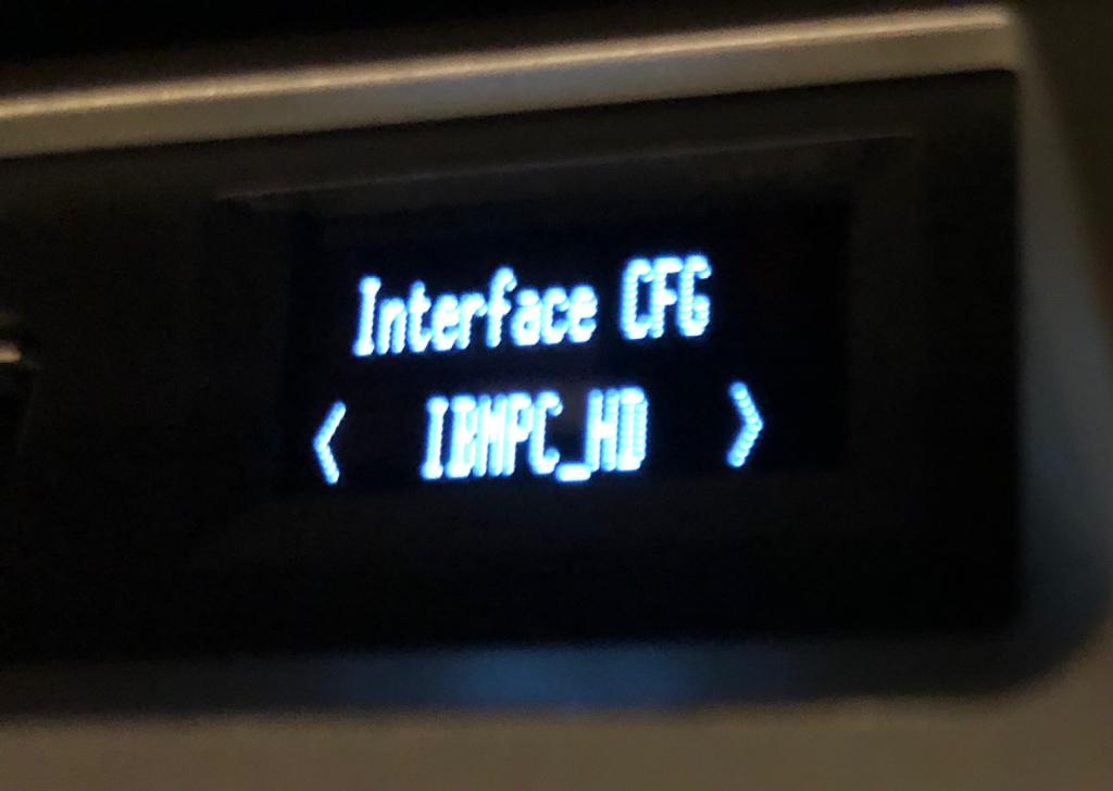

As I've read in some other forums I've configured the unit with System Family as Korg and Interface CFG as IBMPC_HD. Also i've configured it in normal mode and put that config file in the usb stick root (HXCSDFE.CFG).

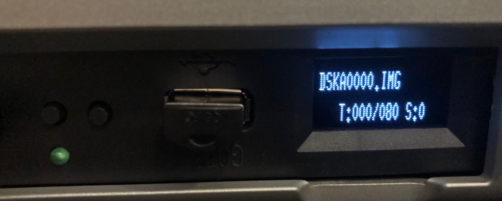

I have some triton files in pcg and sng extensions and tried to make an image (*.img) from them as I've read in other posts. And then put them on the root of the usb but nothing happens. It shows the messages:
DSKA0000IMG
T:000/080 S:0
And
DSKA0000IMG
Choose a File
But i try to connect the triton or make selection and nothing seems to happens.
I'm a bit lost, any help will be very gratefully
Thanks in advance

Re: Gotek with Korg Trinity, How do I start???
Unpack the files present into this zip file to the usb stick root folder :
https://hxc2001.com/vrac/usbstick.zip
If the trinity shows NO Disk and the Gotek green light is on all the time, please reconnect the ribbon to the other way.
https://hxc2001.com/docs/gotek-floppy-e ... lay_strong
Let me know if this is working.
If not we will try to enable the "Non gated mode". (but this shouldn't be needed on the AT32F435.)

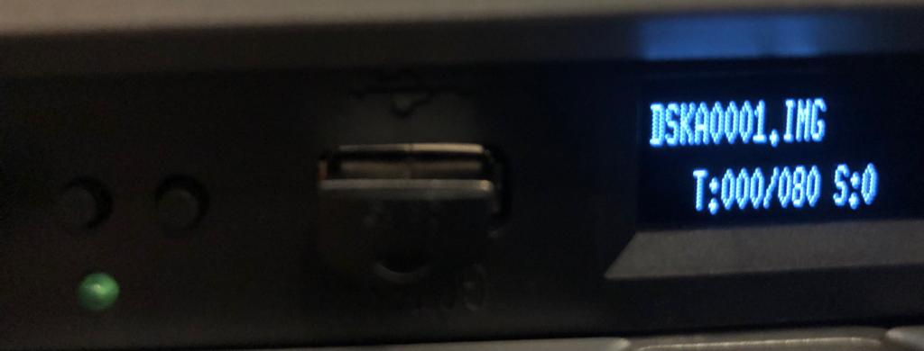

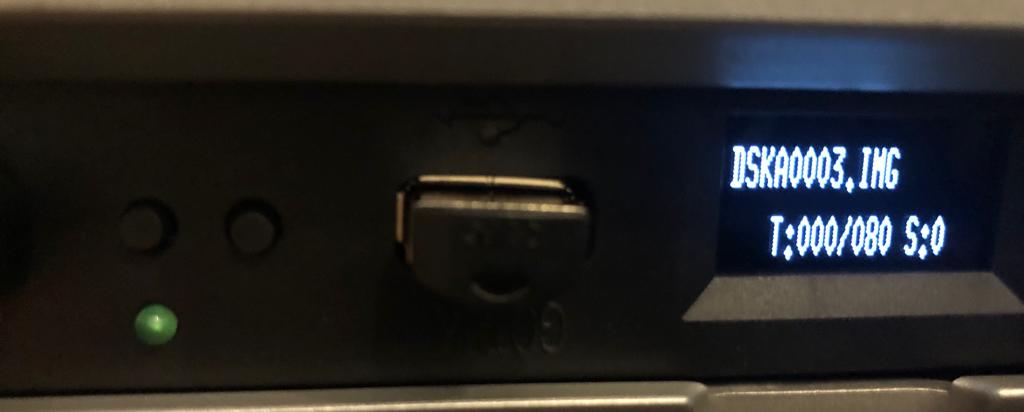

Thank you Jeff for your help and reply, I have done as you said.
But the trinity doesn't stay steady green, although it doesn't read anything either.
Please find attached pictures
- Imagen de WhatsApp 2023-05-14 a las 16.37.452.jpg (25.26 KiB) Viewed 73076 times
- Imagen de WhatsApp 2023-05-14 a las 16.37.45.jpg (24.04 KiB) Viewed 73076 times
- Imagen de WhatsApp 2023-05-14 a las 16.37.415.jpg (30.01 KiB) Viewed 73076 times

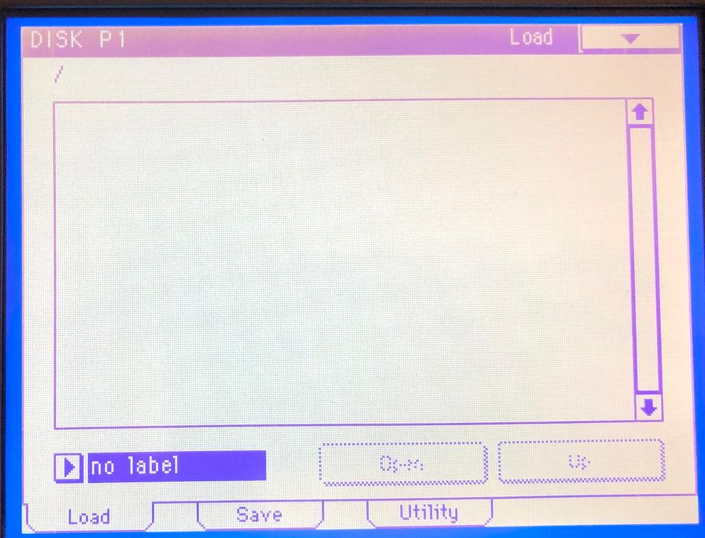

I still don't know how to insert files (songs, sequences, etc...) in the trinity.
- Imagen de WhatsApp 2023-05-t14 a las 16.37.45.jpg (92.8 KiB) Viewed 73076 times
- Imagen de WhatsApp 2023-05-143 a las 16.46.46.jpg (25.72 KiB) Viewed 73076 times
So this seems to work now, isn't it ?Neosynth wrote: Sun May 14, 2023 4:51 pm I still don't know how to insert files (songs, sequences, etc...) in the trinity.
Are you using macOs or Windows or something else ?
On windows you can use a software like winimage.
You can also prepare / format the usb stick to directly add/files to the partitions :
https://hxc2001.com/docs/gotek-floppy-e ... ition.html
(Use gpt_usb_stick_16_1_44M.zip)
