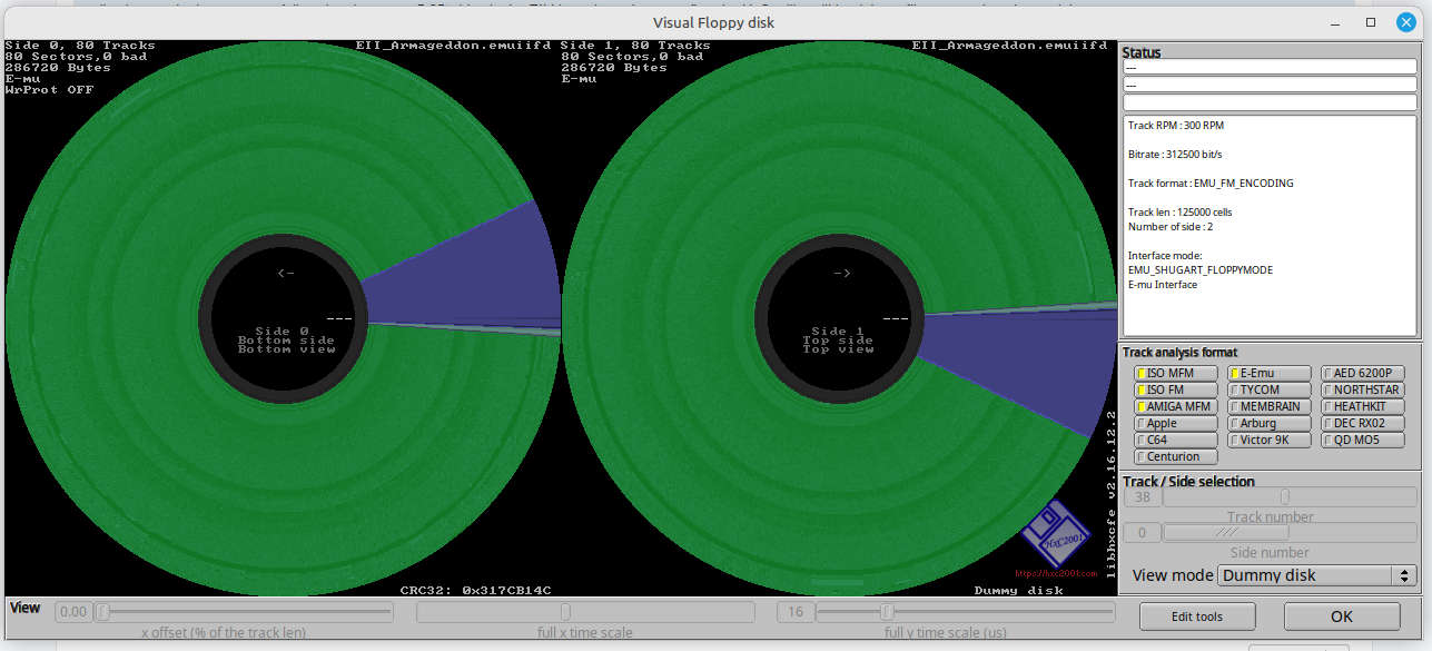

Change the .img file extensions to .emuiifd, then you can load them or batch convert them.
Screenshot at 2025-03-25 11-57-58.jpg (80.52 KiB) Viewed 129760 times

Thanks Jeff,
As ever, many thanks for saving the day! This is just the last bit for information which was needed to complete the task. If anyone wants to download the disk images I have created and put them to use they will up until April.
