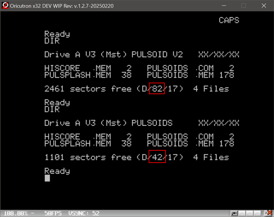

I'm in the process of making physical versions of some Oric games, and since my target system are 3" floppies which have 42 tracks, it was not possible to directly transfer the files since they were made for 3.5" floppies with 82 tracks.
But since these games are only using a fraction of the available storage, my idea was just to format a new floppy in 42 tracks and copy the files, so what I did was to boot Oricutron with SEDORIC3.DSK in drive A, PULSOIDS.DSK (82 tracks) in drive B and UNFORMATED.DSK in drive C.
Then all I did is:
INIT C,17,42,D
COPY "B-*.*" to C
Then I renamed UNFORMATED.DSK to PULSOIDS-42-17.DSK, rebooted the emulator on this floppy and validated that it worked just fine.
Loading each floppy shows the same content, just different number of tracks:
So as far as Oric emulators are concerned, this floppy is valid.

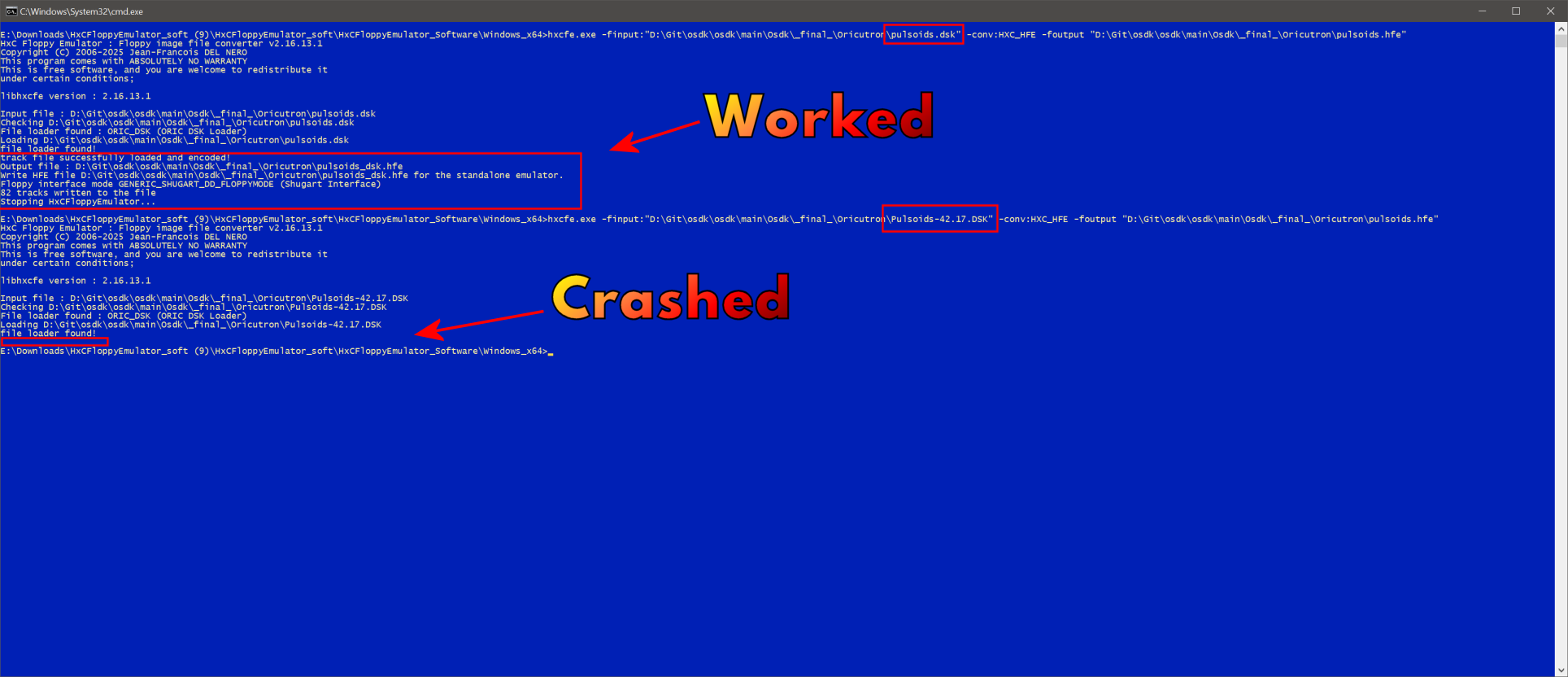

But when I tried to load it in HxCFloppyEmulator.exe or hxcfe.exe it just exploded.

Re: Crash when loading an Oric .DSK file
Why the 42 tracks DSK is sized to 1.6MB ? (this is related to the issue)

Jeff wrote: Fri Sep 12, 2025 9:40 pm Why the 42 tracks DSK is sized to 1.6MB ? (this is related to the issue)
Iss digged in the issue on his side as well: https://forum.defence-force.org/viewtop ... 182#p33182
Basically the problem is that when doing a formatting, the Oricutron emulator does not really know what the size of the file will be, so it allocates as "worth case scenario" disk.
Here are the actual details:
the main issue is in Oricutron - after any write operation DSK's size is automatically extended to:
2 sides * 128 tracks * 6400 bytes + 256 bytes header = 1638656 bytes!
So we end up with a 1.6 meg file with a header that indicates the actual number of tracks.
After patching the "42" to be "128" it loads properly in the HxC tool, but of course now it shows it's a 128 tracks file. I hope that when I try to send that to the Greaseweazle (using the .IMD format) it will just restricts itself to the 42 tracks I mention in the "write" command geometry parameters.
So is the HxC tool crashing because of the discrepancy between what the header says and the size of the file, or something else? I would have expected issues if the header was announcing more tracks than the file actually contained (like truncated file), but here, is it that the tool is trying to process the remaining dummy 86 tracks?
This format doesn't have explicit track size information, so the software have to compute it from the file size and the number of tracks. if you give him a wrongly sized image there is no way to load this properly.
I agree that the software shouldn't crash. I will add some sanity checks to reject these corrupted images.
