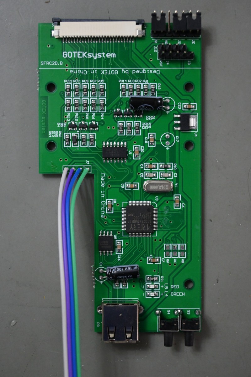

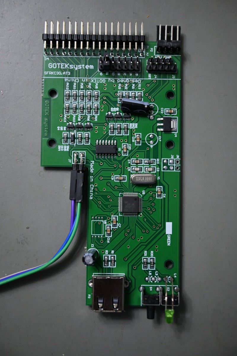

As shown in the attached image, the 0ohm resistors RA, RB and RC have already been removed.
sigh..., sorry Jeff.
- In normal mode, it works fine with flash floppy disks, but not with HxC.
- SFR1M44-DU26(SFRC2D.B, AT32F415RBT7).JPG (232.9 KiB) Viewed 48244 times
- Both normal mode and image-less mode work fine!
- SFR1M44-U100K (SFRKC30.AT3, AT32F415CBT).JPG (237.59 KiB) Viewed 48244 times

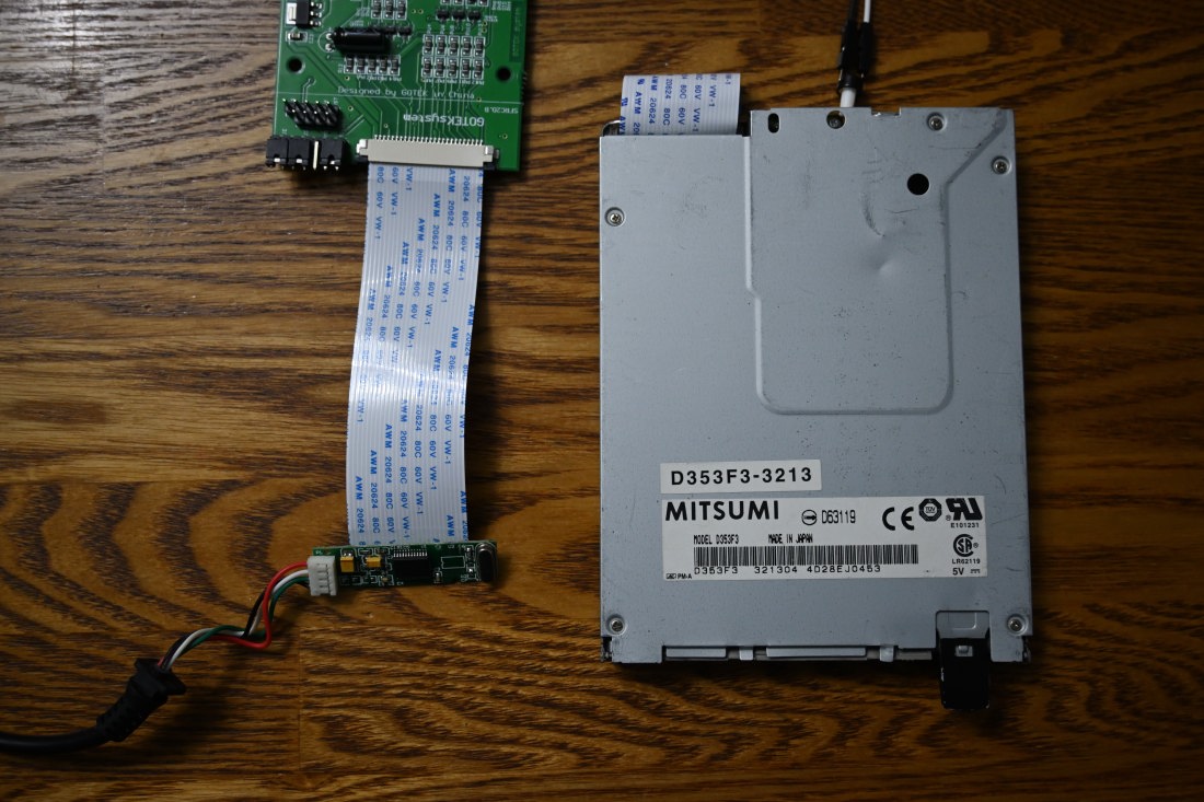

Of course yes!
The USB controller used was a disassembled UF001F that was built into an external FDD drive.
The external FDD drive itself is a MITSUMI D353F3-3213.
I can't test it right now, so I'll give it a little while and report back.

> Have you managed to read something with the HxC Firmware and the DU26 drive and on which machine and with which image(s) ?
It was not recognized at all on HxC.
It was only recognized on flash floppy disk on Windows 11, and formatting and reading/writing were also successful.
> What is this Windows 11 supporting floppy drives ? Are you using an USB floppy controller ?
Of course yes!
- DSC_3524.JPG (235.48 KiB) Viewed 48215 times
Re: A problem with GOTEK SFR1M44-DU26
Totally confusing if i consider your first post ... :newwirequire wrote: Thu Nov 13, 2025 11:18 am > Have you managed to read something with the HxC Firmware and the DU26 drive and on which machine and with which image(s) ?
newwirequire wrote: Tue Nov 11, 2025 11:48 am After various tests, I found that the attached image (dumped from a formatted actual floppy disk using "Floppy disk dump") was recognized.
Both of these images have 80 tracks, which is different from the 84 tracks of DSKA0000.HFE.
Furthermore, these images cause errors when writing to them.
and
thennewwirequire wrote: Thu Nov 13, 2025 11:18 am I purchased two of these drives for my KORG Triton Studio, and both are experiencing the same issue.
i am not sure to be able to help if i got wrong / incomplete information(s).
It seems that you managed to make it somewhat working on the Triton but not with the usb adapter.
Do i understand it correctly ?

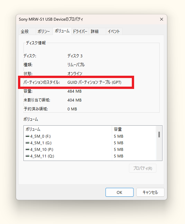

I have a question about image-less mode.
MBR style is fine, but when I write a GPT style image to a USB flash drive using rufus, HxC doesn't recognize it and displays the message "No USB Stick found!"
Of course, I selected "GUID Partition Table (GPT) support".
I also checked the partition style of the USB flash drive written to with rufus, and it's GPT.
Am I missing some setting?
Thank you.
Thank you.
- GPT.png (52.23 KiB) Viewed 48078 times
