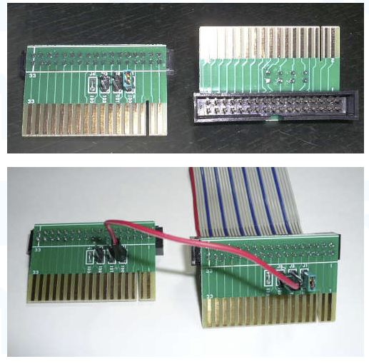

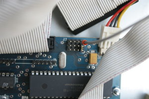

When connecting the HxC to the PC8801 I was not able to use both the A and B drive. The PC8801 has two connectors, one for the A drive and one for the B drive. The solution was to connect the HxC to the drive A connector and run one wire from the B drive pin 10 (motor A enable) to the B drive pins on the HxC.

- Computer side
- IMG_6117_1.JPG (27 KiB) Viewed 140592 times
- HxC side
- IMG_6116_2.JPG (20.14 KiB) Viewed 140592 times

Any one of the 4 pins (drive B), the side turned toward the board border.

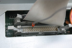

I use a HxC MAX for my PC-8801 MKII SR with 2 drives emulation and works perfectly.
I use also a special connector that I bought in Yahoo Japan Auctions.
The DIP SWITCHES configuration of the HXC MAX must be: 1 & 7 ON, the rest off.

- Connector.JPG (49.84 KiB) Viewed 116583 times
