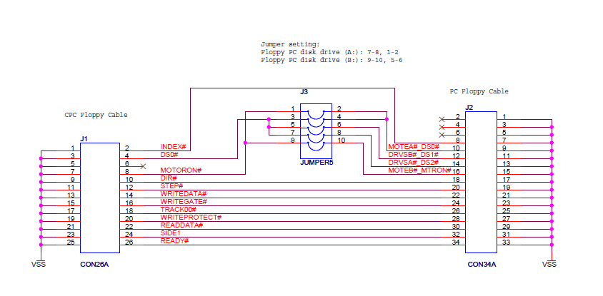

Beaps wrote:Yer thats what I got - sorry if it was not clear
The adaptor:
