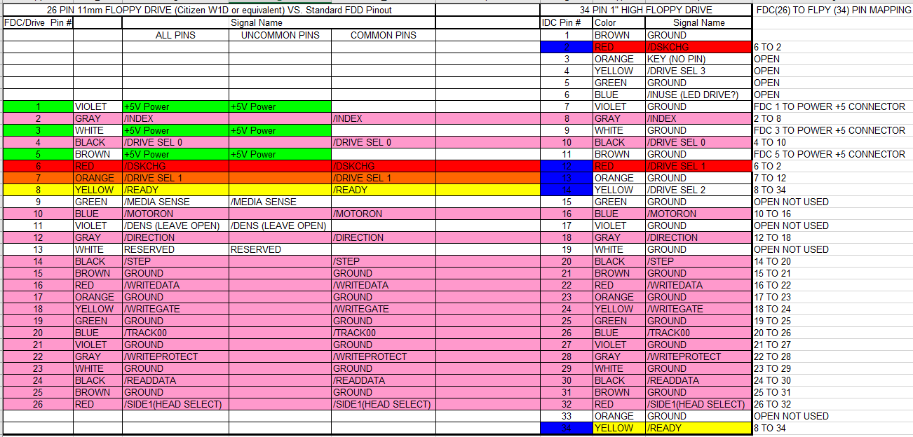

These scopes use Citizen WD1 or X1DE series floppy drives (I have also heard that the Sony MFC930's will work (the bezel is 1mm too high so it has to be trimmed) both use a 26 pin FFC interface so that would require an adapter to be made for the physical difference. The 93XX scope floppy disk controllers use a 26pin male (2X13, 0.1inch spacing) header.
These instruments format floppies and write files that are IBM PC compatible on 1.44MB 3.5 inch floppy disks.

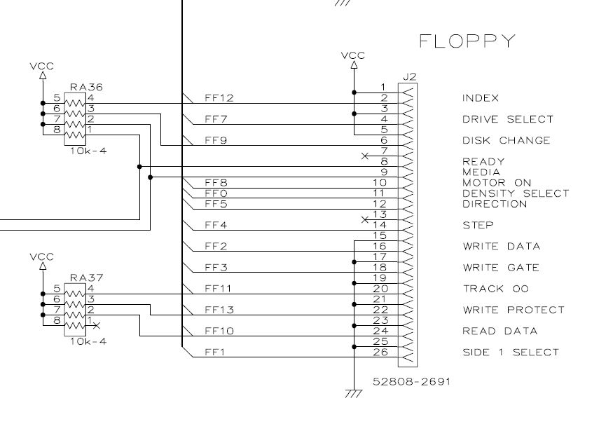

I have attached a zip file that contains information on the floppy drive and the interface as well as a schematic of the floppy disk controller used in the instrument. Note that the drives are thin (11mm) tall drives that are used in laptops and the like. Standard floppy drives will not fit.
If the HxC SD version could be made to work there would be a lot of users that would be interested in them.
The attached zip has information that I have worked out thus far and the LeCroy Floppy Controller schematic as well as the floppy drive information.

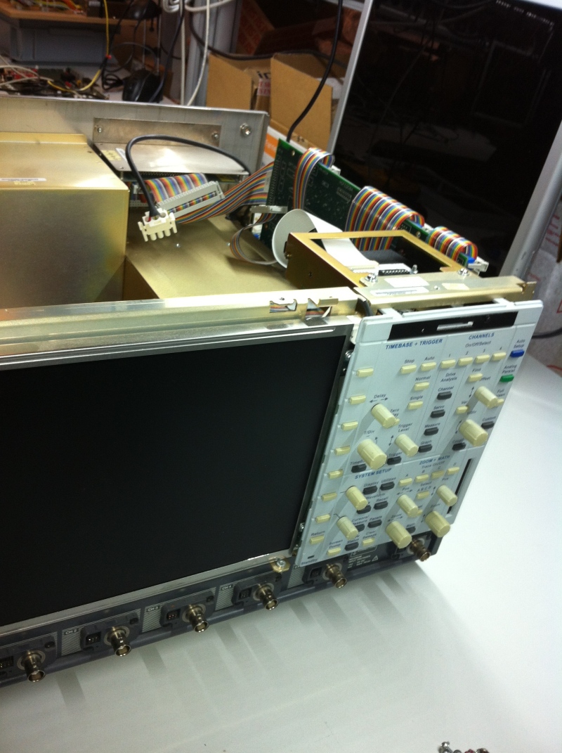

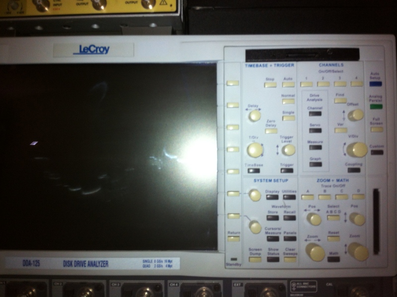

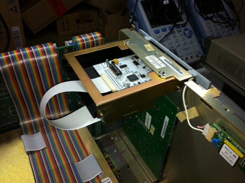

Works out the box without any adapter :D.
More on https://hxc2001.com/showroom
Slim SD HxC Floppy Emulator in a Lecroy DDA125 Oscilloscope.

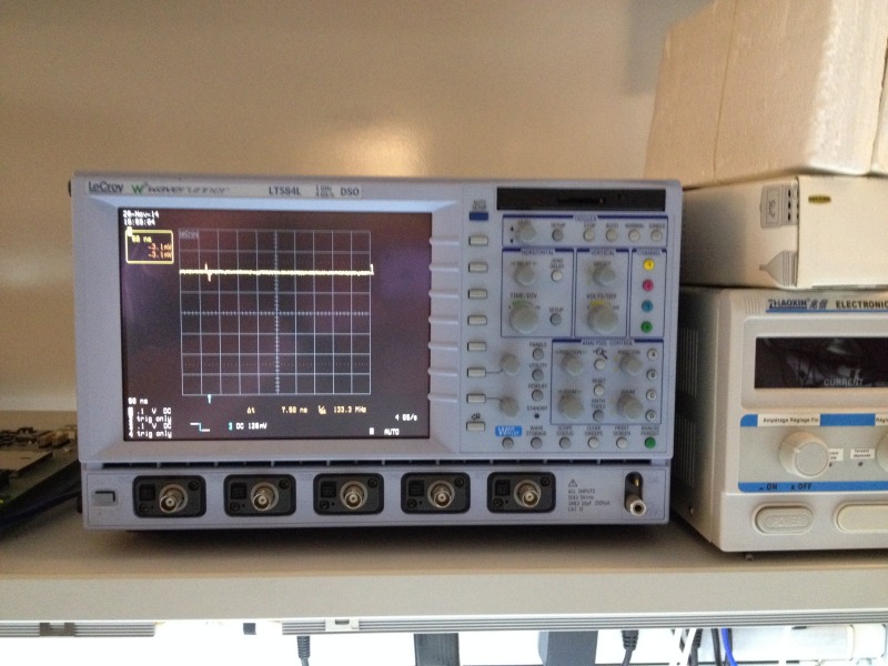

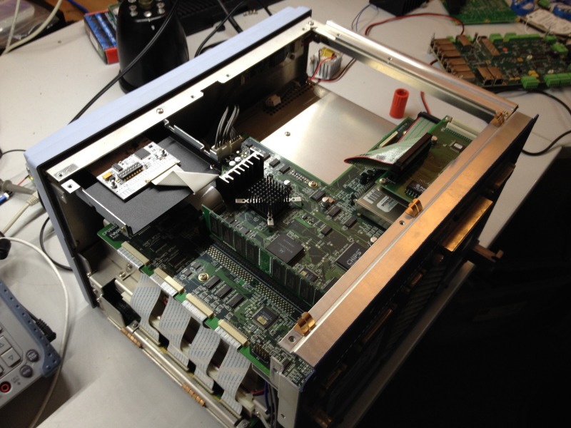

Re: Use with LeCroy Oscilloscopes
Lecroy LT584 floppy disk drive retrofit :

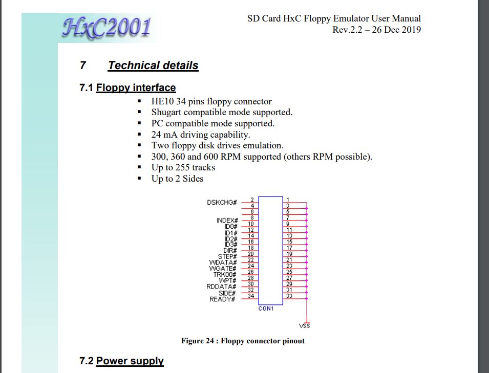

The thre pull up, on witch pins? I bulid in a Lotharek SD Card simulation, it does not work, when i try to print or use the format funktion, the speeker rattels, a counter is conting and the the scope says "no medium inserted". Original config is a Citizen W1D Floppy. I have made a adapter, see picture...
pin changer.PNG (72.8 KiB) Viewed 77195 times
Thanks to the autor!!
I use a finished configuration for a 1,44MB Floppy
Best Regards Christian

then you may have to set/force some additional signals : /MEDIA SENSE.
likeme
Joined: Wed Jul 08, 2020 3:22 pm
Post by likeme »
Thanks, and which Pin connect to MEDIASENS?
I cant find such a pin on the connector of the emulator.
Floppy CON, LT224
likeme wrote: Fri Jul 17, 2020 9:07 am Thanks, and which Pin connect to MEDIASENS?Unbenannt.JPG I cant find such a pin on the connector of the emulator.
Floppy CON, LT224
try first to connect a switch between this signal and the ground.
