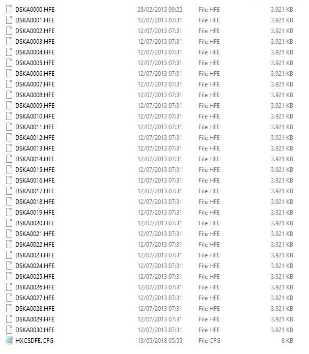

I'm new and I write to you for help on akai s01 and gotek drive.
I've bought from a guy a gotek drive to install on my S01. He sent me it but don't work ! The drive show always and error: "E34". If i try the format, i see always F_F and after E34.
The guy don't answer me (!!!) and I've contacted Jean Francois Del Nero. I've bought the last version of firmware, I've installed it and now the display show me "HxC" with a stick in the drive and "Nor" without stick. Perfect. But I see always "Pro" when I try to format the stick.
Del Nero sent me the image files but they are for the S950 and not work.
Where I can found the files for the S01 ? I've received the S01 from my cousin, with the floppy drive damaged, and he don't sent me the floppy disk for to find the images :(
Can you help me?
Re: AKAI S01
gcipriani wrote: Sat Dec 08, 2018 1:19 pm I've bought the last version of firmware, I've installed it and now the display show me "HxC" with a stick in the drive and "Nor" without stick. Perfect. But I see always "Pro" when I try to format the stick.
Use the indexed mode ! As i said please use the indexed config file and rename it HXCSDFE.CFG !
https://hxc2001.com/download/floppy_dri ... Images.zip
See the troubleshooting :
https://hxc2001.com/docs/gotek-floppy-e ... oting.html
:arrow: This doesn't work : I see "NOR" on the display when inserting the USB stick
The emulator is in "NORmal mode".
Since you don't have any OLED or LCD screen, you need to use the indexed mode or the "autoboot" mode if you have an Amiga/Atari ST/CPC.
In this mode you must use the indexed config file and name the files images DSKA0000.XXX, DSKA0001.XXX, DSKA0002.XXX (replace XXX by the original file extension.) See the usage page for more details.

Jeff wrote: Sat Dec 08, 2018 5:49 pm
Already done. I see the location 001, 002, etc on the stick but don't save the files (always PRO on display when I try it)

Re: AKAI S01
What is displayed on the gotek screen with the usb stick inserted ?
Is the green led always lit ?
the interface mode need to be set to generic shugart (use the attached cfg file attached)
HXCSDFE.CFG.zip
(218 Bytes) Downloaded 2484 times
And the jumper need to set to S0. (remove all others jumpers)
