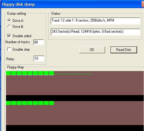

Hey, I purchased the SDCard HxC Floppy Emulator, in try to activate old garage machine which has failed 720kb floppy drive.
I tried to make an image from the floppy (from 1990) with Hxc Floppy Software (floppy disk dump), and although image was created successfully, there was something strange I want to discuss before the real test with the real machine (will be on Sunday).
Attached screenshot of the issue, It looks like something mystery in the floppy, which has 1 special line (data) in the right part, when all the other data is in the left side, and in the output it was copied to the left part. I am afraid it is a specail floppy-protect procedure, that may prevent the machine from start.
Does anybody know about such a strange behaviour of a floppy and how to deal with it?
I can upload file-image of the floopy (created by dd-linux) and the hfe file, if it would be able to help.

- screenshot of the issue
- screenshot-1.JPG (38.1 KiB) Viewed 96771 times

Send me the floppy images (img + HFE) by email, i will have a look.netanel_h wrote:Hey, I purchased the SDCard HxC Floppy Emulator, in try to activate old garage machine which has failed 720kb floppy drive.
If possible remake an floppy dump and export into the AFI format. after send me this one too.

I got the image file, and without hesitation i can tell that this is a copy protection.netanel_h wrote:Hey, I purchased the SDCard HxC Floppy Emulator, in try to activate old garage machine which has failed 720kb floppy drive.
The track 9 side 0 have 16 sectors "mixed" together (the start of the next sector is in the data part of the previous one).
This is a common protection used on video game disk (Atari ST...).
Some game have up to 255 sectors in one track -> doesn't fit on a normal track if you don't mix them. By this way you cannot copy the floppy disk with an normal computer.
Regarding the dump you have done, this is not exactly the real track layout of the disk, anyway the protection should be fooled because all 16 sectors are on the virtual track (this track contain more data than the others in the hfe file) .
So try the HFE file, it may work. (Don't forget to change the HFE interface mode to Shugart)
Remember that the protection is at the track 9 -> the hxc show the track number on the lcd during reading. This may help to understand if the protection is working or not.
if the garage machine hang at the track 9, other dump tool/solution should be used. (more details if needed).
(there are maybe something else at the track 79...)
Question : Was this floppy disk formatted/created by the machine or is this an original disk ?
Re: Strange floppy behaviour
The disk is the original, machine can't foramt or do anything with the floppy, only read it (I suppose).Jeff wrote:Question : Was this floppy disk formatted/created by the machine or is this an original disk ?

Test passed and IT WORKS!
There was no need to any modification, out of set the jumper to Shugart-non-twisted. Dumping of the floppy with floppy disk dump option and export it to the hfe format was enough to do the magic and bypass the floppy copy-protection.

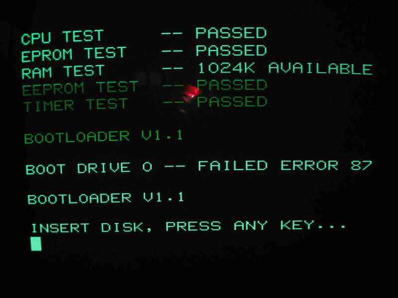

Hi mate,I read your remarkable acheivements regarding the MSC200sl floppy emulation on hxc2001.com forum I also have the MCS2000SL hardware, however the second floppy would not read at all.Are you able to help me?Thanks in advance!

I have 2 floppy drives (left and right). It appears one of them is a booting OS. When it comes to loading the second floppy I get the error, attached.
The hardware very similar. The model is exactly the same as yours.
I had only one 720kb floppy which boots the machine, without need to replace floppies in the middle. By the way, you have 1024k memory, I had only 768k...
Any image of the floopy (e.g. DD\linux) to an new floppy fails because of the copy-protection (see upwards), only the dumped hfe file works with the HXC emulator, do you have the emulator?
Isn't anyone who still sell the old floppies with the original software in your country? In Israel there is still a company which sells them, however, it's a Hebrew-translated version (and I have only the files of the Hebrew version). If you want the files, please post your email address here.
